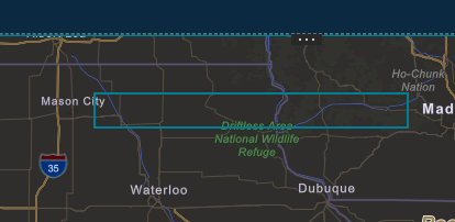

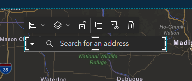

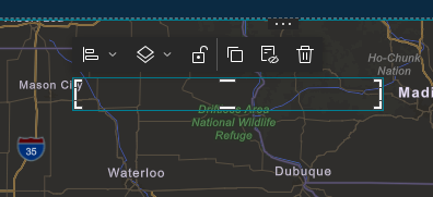

This appears to be a great widget if i can get it to behave. It disappears on me. Well it looks like it drops behind the map, or sidebar, or header as if the arrangement put it behind or below those items. The search bar is always there, but sometimes just hidden. this happens both in Preview and Live View. Dragging the search bar to a new area of the application usually makes it 'reappear' but then eventually it disappears again.  "exbVersion": "1.20.0", "exbBuildNum": "1290", Enterprise 11.5
Thoughts?

Thank you for reporting @MicahWilliamson, let me try and replicate on my end to see if I can get a patch out. Thank you for the environment info, we are both on DE 1.20 and Enterprise 11.5.

07/07/2026:
Fixed the search bar showing up blank on config import or hiding behind the map/header/sidebar in some layouts, and hardened imported-config handling reported by @MicahWilliamson. Updated ZIP and GitHub. Please reach out with any issues.
