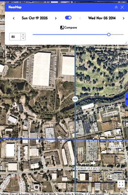

ESRI Australia developed a very good Widget for displaying Nearmap imagery. Simply enter a valid API key and it will display the Nearmap imagery from your subscription. It even integrates a swipe function for comparing imagery of various ages. It's great!
...And with the Experience Builder 1.19 update, it's broken. At least, that fancy swipe function.
I have re-built the swipe functionality using a graphic layer that can be clicked and dragged. I have also added a numeric input and a slider inside the Widget interface and migrated the Widget to use Components.
Note: You must be a paid Nearmap subscriber and obtain a valid API key from Nearmap to use this Widget.

That's neat! Thanks for sharing. This would be a great internal tool to have. Does it allow users to zoom/pan within nearmap? Or do you set the zoom and extent? Panning around and zooming can make a lot of requests to the server and eat up your nearmap limit so I'd be hesitant to share an app with this widget with the public.
JeffreyThompson2
MVP Frequent Contributor
@JamesPoeschel We don't use this in a public facing application, but it does get heavy usage in an internal application. Our contract with Nearmap allows for unlimited access to the tiles in our area.
