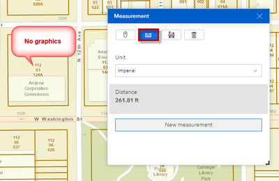

Measure a Line
I see the distance is being calculated correctly. However, the graphics are not showing up.

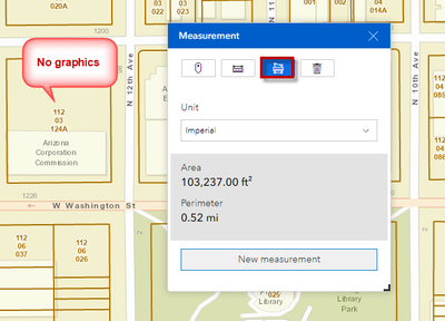

Measure an Area
I see that the Measurement widget is reporting the Area and Perimeter, but the graphics I am drawing on the map are not showing up.

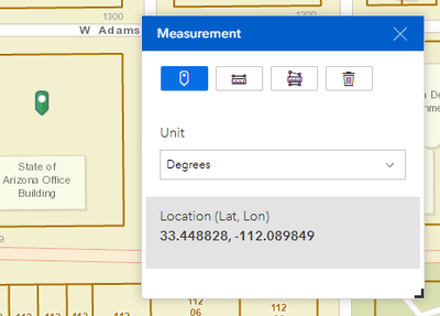

Measure a Point
I do see the point on the map.
This is working.
