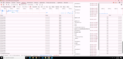

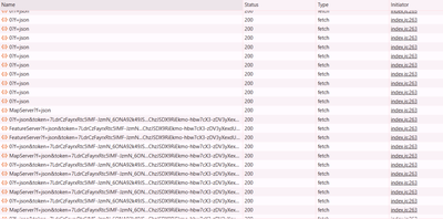

Hi Team,
We have a web map with group layers and feature layers as sub layers. Visibility of all these layers is set to off in web map itself. This web map is added to ExpBuilder App > Data tab. Used it as source for Map widget. Though the layer's visibility is off in web map itself, on load of the experience builder app, its sending request to all the layers. Why is it sending requests to all the invisible layers?
We are suspecting it is because the web map is added to Data tab and app is creating data sources. Can we avoid this?
Any pointers on why this is happening. Thanks in advance!

Yes, the data from invisible layers will still load with the rest of the map. If you don't want the data to load with the map, you can add data at run-time, but that comes with it's own set of challenges and drawbacks.
