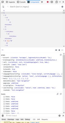

JeffreyThompson2
MVP Frequent Contributor
Have you tried the React Developer Tools add-on? It adds some extra panels to your browser console allowing you to directly inspect props and state.
GIS Developer
City of Arlington, Texas
