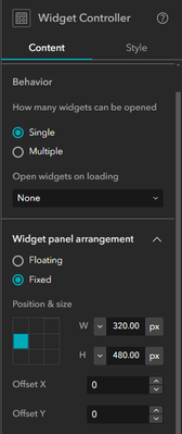

If you switch your Widget Controller to a Fixed Panel Arrangement, you should be able to place it wherever you want it.
