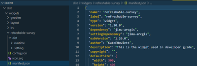

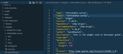

Thanks for that, I actually copied the folder name and pasted it into the manifest to avoid exactly that problem! The first picture is the manifest under your-extensions/widgets, and the second is the manifest under dist/widgets
So it's definitely copying over the files from your-extensions/widgets, it just seems to be copying them over but without applying changes. I wasn't able to add pictures before but I can now, so re: number 2 on my list.
The file on the left is the one in your-extensions/widgets, and the one on the right is the one in dist/widgets, you can see that there is a ? in the your-extensions file but not in the dist file.
I hope the screenshots make it a little clearer? And apologies for the lack of clarity before, I'm very new to it all so I appreciate your response. I'll have a look at your primer though, thank you.
