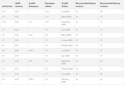

Each version of Experience Builder is linked to a specific version of the JavaScript API, so if the Timeline widget incorporates features from one of the latest versions of the API, there may not be an easy way of bringing it into Enterprise.

Thanks again for your remarks. It is most likely a problem of versions. I suppose I'll have to wait.
