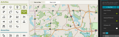

For my first 'Custom' widget, I have modified the out-of-the-box filter widget by exposing a few properties that aren't present in the filter style pane, and tailored the display of the filter to focus on using an icon as the primary way a viewer interprets the filter query.
The reason I wanted to create this was because I had a situation where I wanted to set quite a few filters without the scrolling list growing too long, but also not feeling quite so jam-packed that a pill button selection mode can sometimes seem. I took inspiration from a ESRI-developed application for Get Ireland Active that did this and I thought was a really good way to address those issues. The general interface can be seen below:

After downloading and extracting the widget to your deployment's client/your-extensions/widgets folder, add the widget to the map. Here I have exposed three color properties to extend the styling of the filter pills. Hover Overlay will change the color of the pill when hovered over, Selected Pill Border will override the Jimu styling that determines the border color and corner-thing color once a pill is selected, and Pill Button Fill allows you to select the base fill color of the pill.
