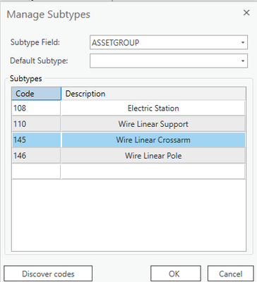

MikeMillerGIS
Esri Frequent Contributor
It is to model features that do not need to be included in the network index.  Such as the Fence Lines on an electric station.  We have cleaned these up some.  Here is the current list:
