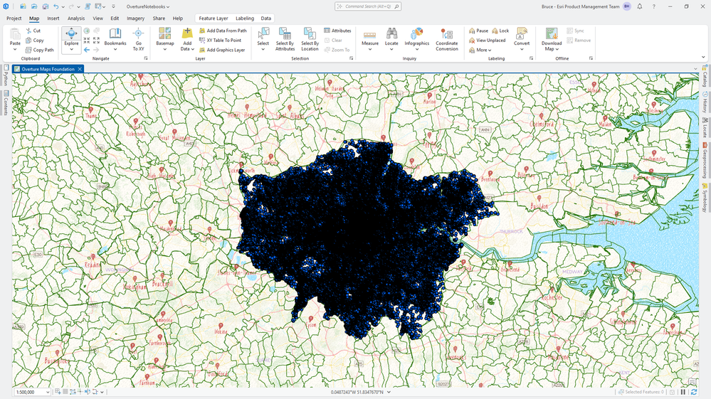

You're not here for the cartography, and to prove it here's a map of my subject matter data:
Division Areas and Places in greater London, GBDivision Areas and Places in greater London, GB
Overlaying a Colored Pencil  basemap, there are global extent Division Area  polygons and Places point features within an area of interest (greater London, UK) defined by selected division area features.  What you can't see, but we'll get to, is that separate POI-role locators made from the division area and places features are active ArcGIS Pro project locators in the map.
The division area polygon layer (transparent with green outlines) is global, with over 1M features.  Division areas go from country down to microhood size, so to help with display I sort them by area (descending), so they look quite busy in the map, but you have flexibility in area of interest definition.  For the places points, there are over 417K features (dark blue dots) in the area of interest, which at the map scale shown (1:500,000)  makes the symbol density very high.
Together, the division area features, places points, relationships to alternate value tables and associated locators for each layer are my information products, which will be maintained by one-click automation on demand in two notebooks shared on OneDrive, one each for division areas and places.

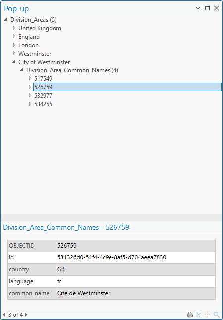

or identifying translated names for a division area feature...
Division Area name translationsDivision Area name translations

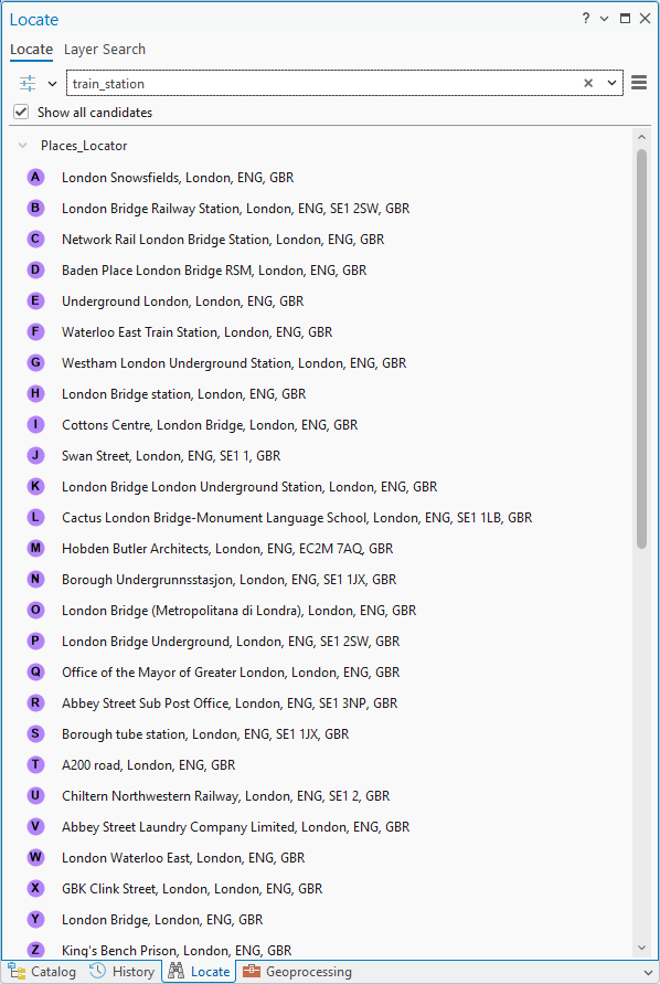

One of the higher value themes from Overture is places data, and the locator built from that data provides a compelling map navigation experience - using place category as a hint to refine a geocode.
For example hinting I want to find a train station:
Train StationsTrain Stations

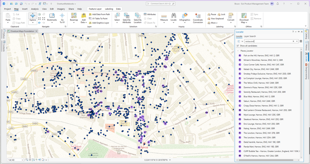

Or a restaurant in my map extent:
RestaurantsRestaurants

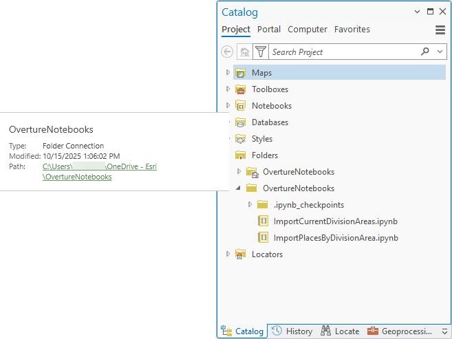

Sharing notebooks to OneDrive
The notebooks are suitable for external consumption.  They automatically detect the changing input path at run time - so are good candidates for sharing to OneDrive, from where your colleagues may run them on demand - the "one click" experience.  OK well maybe two clicks, open the notebook then run it 😉..
To share the notebooks, create a folder in OneDrive, copy the notebooks into it, then share the folder and notebook source files to anyone, with edit permission.  People invited to the folder can use OneDrive's browser-based controls to add the folder to their local files, then from Windows Explorer drag the folder connection into an ArcGIS Pro project folder connection.
Notebooks on OneDriveNotebooks on OneDrive
Ready-to-use notebooks are in the post attachment.  You'll need ArcGIS Pro 3.3+ standard or advanced license.  ImportCurrentDivisionAreas takes about 30 minutes to run, ImportPlacesByDivisionArea about 15 minutes for the area of interest shown, this will vary with the area you use.  Do not run both notebooks simultaneously, they have variable names that will collide.  Do comment in the post with any experiences you want to share, or questions you have, for example who would like the Addresses theme supported with a locator output?  I'm guessing many people...

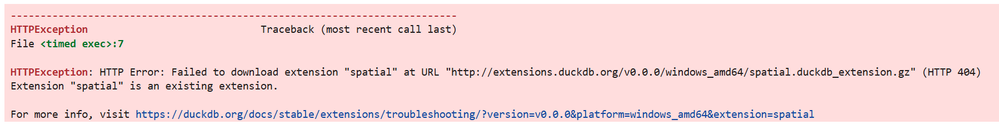

Thanks for this.  I am getting an error installing the DuckDB Extensions:
I can't work out why it is trying to get the extension from v0.0.0
have you seen this and maybe know how to force a version?

Hi Marc, do you mean you get this error when importing duckdb or is this when adding DuckDB to a pre-3.5 Pro Python conda environment?  The spatial extension is already available in Pro 3.5+.
BTW, Overture is broken at the moment, people are looking into an issue in the registry, which the notebook uses to determine the latest release.

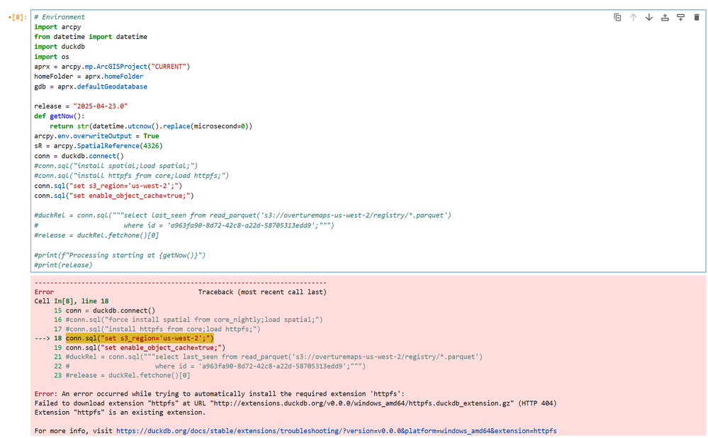

Thanks for the update about Overture.  I might park this for a bit to give them time to sort it.
The errors come at the very beginning of the notebook.  This is in Pro 3.6 beta btw.
If I comment out a few lines to just try and set the region I get the following similar error for the httpfs extension:
I have googled and cannot find any reference to where it does not pull the latest version, and defaults to v0.0.0.
Thanks,
Marc

Thanks, you might have hit a bug - I'll get this to the right people.

The team tell me DuckDB was broken in Pro 3.6 Beta 1, it's fixed in later builds.
Marc_Graham
OK, I will update to the latest Beta. Thanks.
