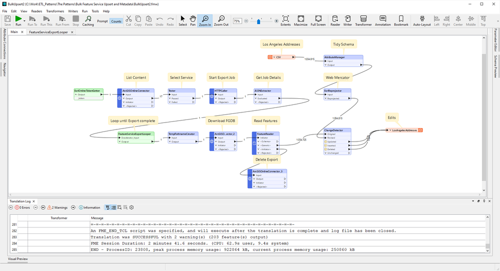

The post download has a toolbox with the Pro 3.4 ArcGIS Data Interoperability ETL tool in it - see BulkUpsert2.  The tool reads a CSV file at a URL (also avoiding serialization, which is the default for the server), but also accesses portal content to trigger a file geodatabase export, wait in a loop until the export is finished, then downloads and reads the target feature layer content, not the service, and finally deleting the export item (the downloaded file geodatabase is also automatically deleted).  This is core functionality.  There are two mint green custom transformers in the tool.  An EsriOnlineTokenGetter retrieves a token needed for a later HTTP call (if you are working with an Enterprise portal you would use an EsriPortalTokenGetter).  The other custom transformer is a looping transformer you can inspect in its tab labeled FeatureServiceExportLooper.  It checks the export job status every 2 seconds until the job is complete.  Note that how long an export job takes is dependent on how big your service is and also how busy the host portal is - I have seen ArcGIS Online queue jobs as well as run them immediately.  Here is a run taking a little over a minute (just for the export) at a busy time in ArcGIS Online:

Hi Everyone, here is a real run with a day's worth of changes in a 1M-record city address dataset found and written in 2 minutes 41.6 seconds (45 updates, 124 inserts, 34 deletes), less than half the time it would take just to read the target feature service into the tool.  Note I edited the tool to write updates, inserts and deletes, not upserts and deletes, as the asynchronous nature of upsert writes is less suited to small jobs.  Enjoy!
Changeset WriteChangeset WriteChangeset Write
