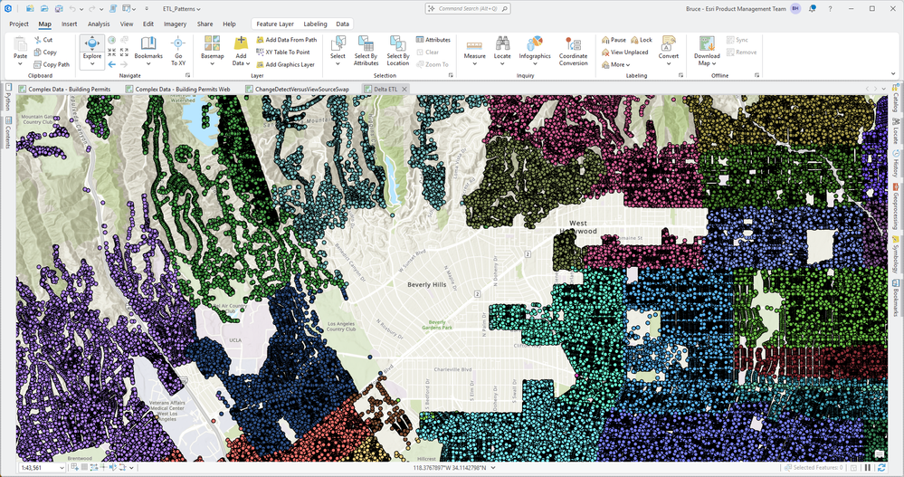

My subject matter data is the same as the previous blog, street address points for the city of Los Angeles, updated daily.
Los Angeles Address PointsLos Angeles Address Points
There are a little over a million points in the dataset, with a few hundred changes daily: inserts, updates and deletes.  I've been keen to write about an upsert use case (the combination of insert and update in a single transaction) for a while, as it is now supported with the Append geoprocessing tool in Pro and hence in ArcPy in the notebook advanced runtime.

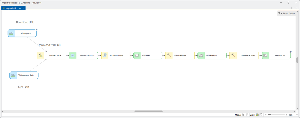

Back to the tools used.  In the blog download you'll find an ArcGIS Pro 3.6 toolbox with a model.  The model creates a file geodatabase feature class named  Addresses using CSV data it downloads from the city Open Data site.  The feature class has a tuned schema (see the field map control in the Export Features tool) and also a primary key field House_Number_ID with a not-null constraint and an index, requirements for using upsert transactions.
