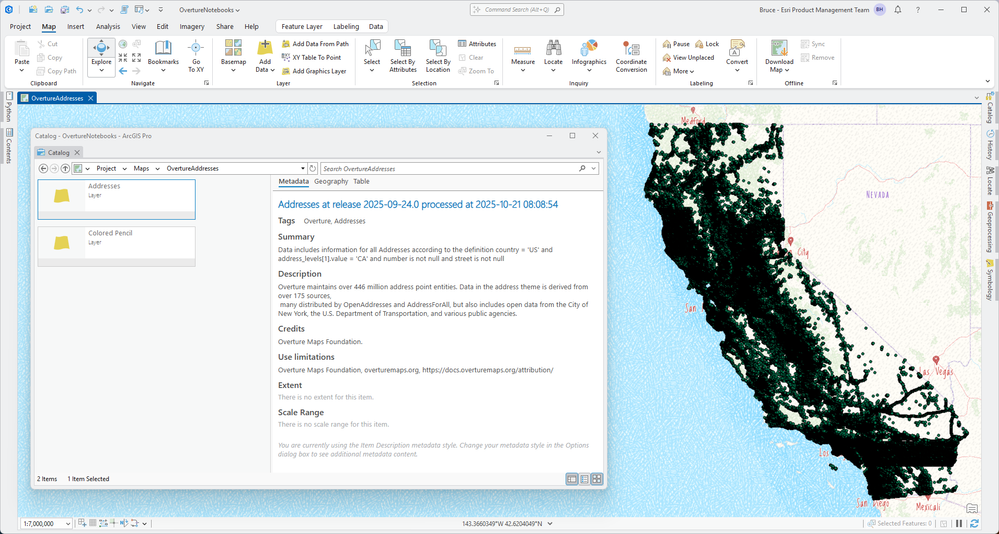

Building on earlier work using an ArcGIS Pro notebook to ETL Overture Maps Foundation data into ArcGIS, this post takes a look at Overture Map Foundation's Addresses theme, as both a map-ready layer and subaddress-capable geocoding locator.  At writing the data is in alpha release, but you can take a look with the ArcGIS Pro notebook (in the post download), which is configured to extract the address points in California, USA - a little over 14 million features.  Here they are, with metadata also created by the notebook:
14 million address points in California14 million address points in California

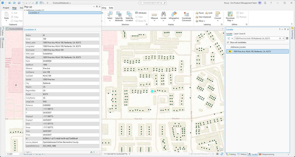

There are many uses for the address points (map layer, near features, join features, geometry source for editing...), but one I want to highlight, and which is mentioned by Overture as a target workflow, is geocoding - turning address details into map locations, like you see here for the address "1000 Pine Ave Unit 109 Redlands CA 92373".
Geocoding with Overture AddressesGeocoding with Overture Addresses

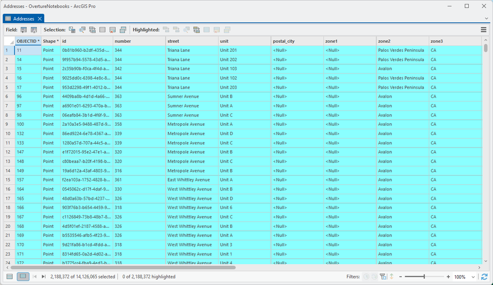

I'll let you surf the notebook for other details, for example a bounding box around each address point is calculated to provide a more usable zoom experience when locating an address.  The notebook will create a locator in your project home folder or rebuild it with new data if it already exists.  To use the rebuild option, first remove the existing locator from your project to drop file locks on it.  It takes about 45 minutes to process the Californian data, including one ~5-minute step where street, unit and zone fields are consistently cased - for appearance' sake:
Consistent casing of text fieldsConsistent casing of text fields
