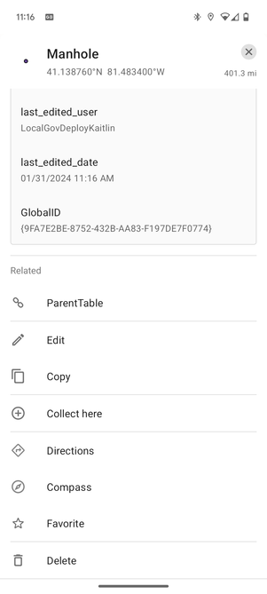

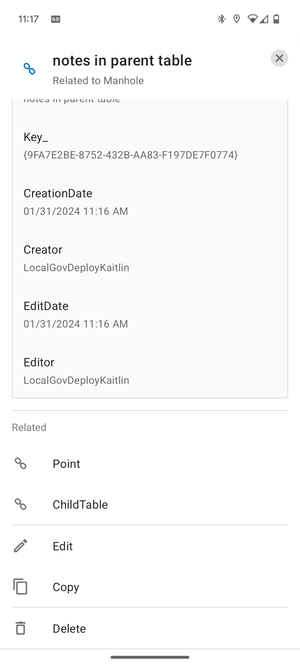

Hi @JordanHeiman yes - that is possible! I just tested it and provided some screenshots. 1. This is where I clicked on a point and saw the related Parent table. 2. After adding a record to the Parent table, I could also add a record to the child table. Now I can see the parent table is related to the point and the child table. I would read this tech support article first to make sure your data relationships are set up correctly for Field Maps https://support.esri.com/en-us/knowledge-base/how-to-set-up-related-tables-in-arcgis-pro-for-use-in-.... You would need to create a relationship class between the point/line/poly layer and the parent table AND create a relationship class between the parent table and child table.
