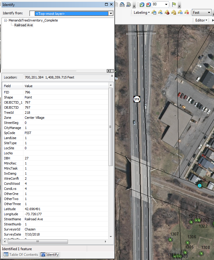

I am conducting a Tree Inventory and our GPS recorder was not accurate. I spent the time to move all the points around in GIS using the editor to place them in their correct locations. However, when I move the points, their latitude and longitude are not updated in the attribute table. So when I export the data to Excel, it does not have the updated coordinates. I want to export to Excel to have a database of all the tree information.
Is there a way to have latitude and longitude by a dynamic part of the attribute table? Or a way to update the new coordinates that have been dragged?
Point in incorrect location. When point is moved and the identify tool is used again, the coordinates are not updated. This image shows where tree is meant to be. If you look at other picture provided, the latitude and longitude have not been updated after using the identify tool on both.
Please Help.

Is it an event layer or a shapefile you are using or a feature class?
X, Y coordinates won't get updated unless you recalculate those fields... preferably in new fields to retain the old information... IN featureclasses Shape_Length and Shape_Area should get updated
You can use Calculate geometry from the table or Add XY coordinates from arctoolbox

DianeTirianto
New Contributor
Hello there,
This worked. Thank you!
