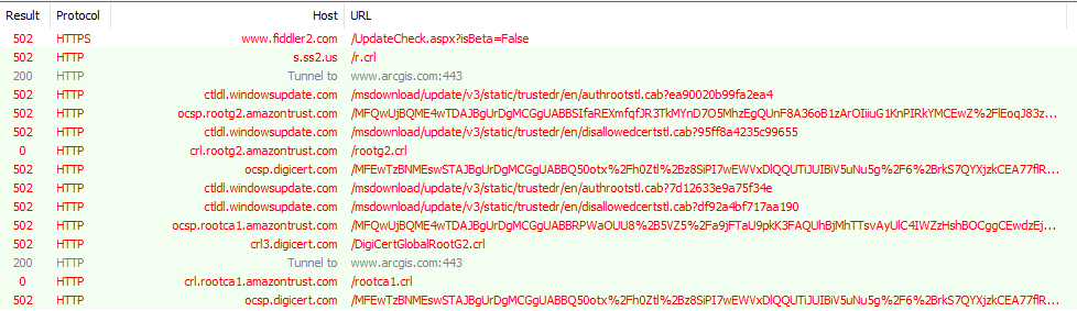

Given the error, we needed to check to see if ArcGIS Pro was having an issue accessing an OAuth resource or perhaps some generateToken call was failing. To do that, we broke out Fiddler4.
While using Fiddler to monitor the web traffic between ArcGIS Pro and ArcGIS Online while adding content, we immediately noticed that none of the CRL/OSCP links were accessible - the error was HTTP 502 (bad gateway).

An HTTP 502 (bad gateway) blocking these URLs is suspect. OCSP and CRL links are expected to be accessible via plaintext HTTP.  After all, if a certificate is compromised, how do you validate the status of the certificate using HTTPS? The Windows crypto API won't even try to connect to a CRL or OCSP link over HTTPS. So why were these resources blocked?
The answer was simple - the customer had included this host in a firewall policy that blocked all outbound plaintext HTTP - including CRL and OCSP.
