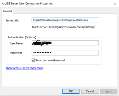

2. In ArcCatalog, GIS Servers > Add ArcGIS Server > Use GIS Services
Server URL: https://elevation.arcgis.com/arcgis/rest/services

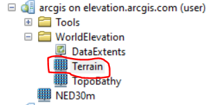

3. Expand the Server connection, and add the Terrain Image Service to Table of Content of ArcMap. You may need to provide the login credentials again.

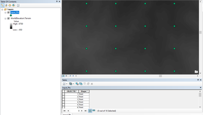

Input

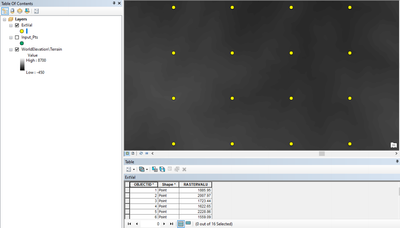

Output
