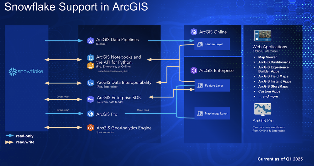

Customers frequently ask about various approaches to integrating Snowflake with the ArcGIS platform. At Snowflake, we have seen constant growth in customer adoption of Snowflake for various GIS-based use case scenarios. The diagram below lays out the different access patterns between the two platforms.
You can get to know more details about these integration points here: ArcGIS and Snowflake.

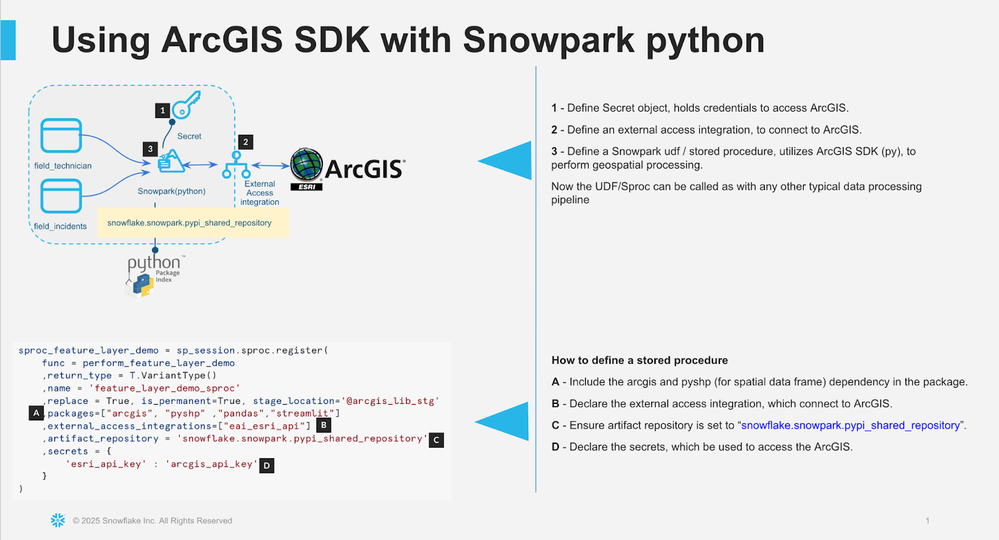

In general, Snowflake customers have asked us to develop a solution whereby they can bring in bespoke Python libraries from PyPi into their various data processing pipelines. As an answer to the call, Snowflake made this possible, as explained in this article, by allowing access to PyPI packages in Snowpark via UDFs and stored procedures. However, there was a limitation that only Wheel (.whl) based Python libraries were possible. Due to this limitation, the ArcGIS Python SDK could not be used within Snowflake, as its dependent libraries were not necessarily wheel-based. Recently, Snowflake worked on this need and now allows various sdist packages to be used in Snowpark user-defined functions (UDF)/stored procedures (sproc). This means we can now use the ArcGIS Python SDK directly within Snowflake.
Adoption Overview
The diagram below explains how customers can now use the ArcGIS SDK in Snowflake.

Github Gist:  sfc-gh-vsekar/DEMO_BATCH_GEOCODING_SPROC.ipynb
Here are some examples that demonstrate how to do this. Note:
  • These demos are not production-grade; the idea is to showcase the main highlight of using the ArcGIS Python SDK.
  • All the notebooks are Snowflake notebook-based and can be run by importing them.
  • All of these notebooks follow similar steps and can be run independently. The main logic for creating and defining the stored procedure is in the cell named: define_spatial_processing_functionality
Snowflake Notebook: DEMO_BATCH_GEOCODING_SPROC:- Demonstrates how to perform batch geocoding service, by reading a table from Snowflake, invoking ArcGIS, and populating the table with the geo-coordinates.

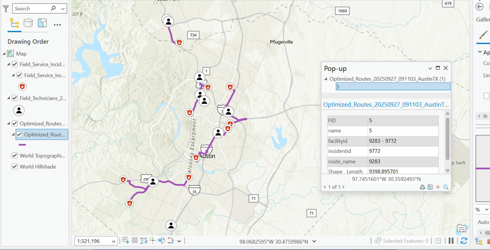

Snowflake Notebook: DEMO_FIND_CLOSEST_FACILITY_SPROC:- This service demonstrates advanced functionality, Routing / Network: find the closest facilities. Some use cases where this service can be adopted are in a dispatch scenario, for example:
  • Sending a cell tower technician to a location where there is an incident with cell towers
  • Ambulance services
  • Alarm security officer dispatch
The image below is a map, based on various feature layers published by this demo:
