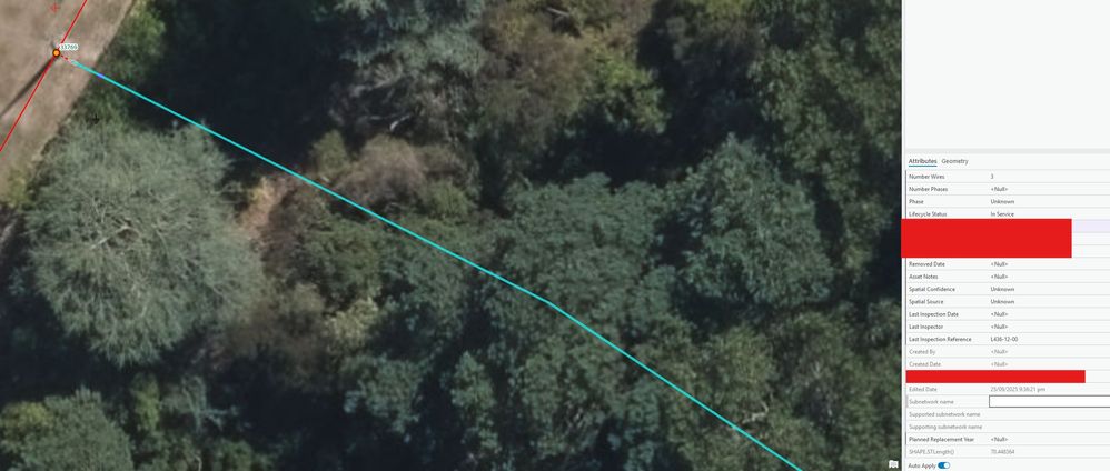

gis_KIWI4
MVP Regular Contributor
@EdwardBlair - I am noticing the opposite of what you have suggested.
I have opened up a fuse. After the subnetwork update -
The fuse has the SUBNETWORKNAME field populated but all assets downstream of it have the SUBNETWORKNAME blanked out.
 After "closing" the fuse and updating the subnetwork you can see the subnetwork name restored. (Ignore the "::" that an unrelated issue )
