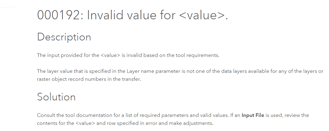

SrinivasaRao1
where will be the tool documentation, please let us know
