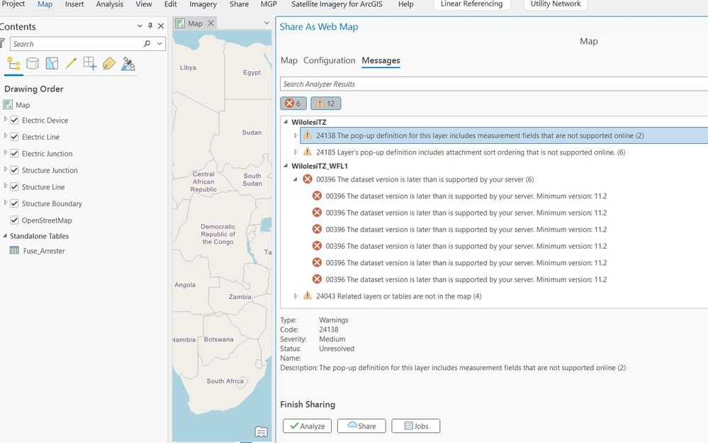

Review the attached photo. I wanted to publish feature layers as a web map in ArcGIS Online.  IError by version.jpg

Have you read 00396: The dataset version is later than is supported by your server. Minimum version: <value> - ArcGIS Pro | Documentation ?  That kind of error message is more common when publishing to ArcGIS Enterprise, but one can run into it with ArcGIS Online in specific situations.

This may be coming from field compatability between your UN based feature layers and what is supported by ArcGIS Online. Take a look here Field Types in ArcGIS Online, Best Practices and Compatibility
Depending on the UN schema version you are using you may find that your feature classes have unsupported (in AGOL) types.

If your UN based feature classes have been upgraded over time with new releases of the UN schema at new versions of ArcGIS Pro this would have modified data types on your feature classes.
You can see the history here Utility network upgrade history—ArcGIS Pro | Documentation
In particular, if you have updated to UN schema 7 it uses a new 64 bit datatype for objectid which I don't believe is fully supported in AGOL at this time.
