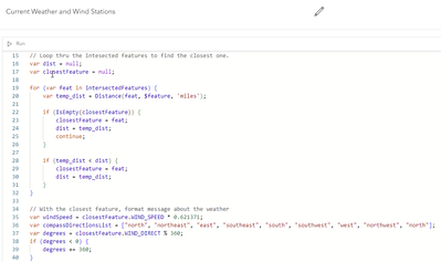

  1. Add context with weather data from the ArcGIS Living Atlas

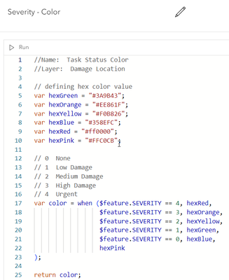

  1. Draw attention to important information with attribute driven text color.
