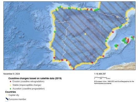

The Portuguese coast, defined as the strip of land along the sea, faces significant erosion challenges, resulting in the retreat of the coastline and the loss of territory (REA, n.d.). Over the last few decades, coastal erosion in Portugal has been significant, with severe erosion rates in several areas, especially in the northwestern sector of the country (Pinto et al., 2020). Erosion is affecting the Portuguese coastline from North to South: between 1958 and 2021, the Portuguese Environment Agency (APA) estimates that 1320 hectares of land have disappeared. Only 45% of the shallow sandy beaches in Portugal are under erosion? Only in recent years, the Monitoring Program for the Coastal Strip of Continental Portugal (COSMO), coordinated by the Portuguese Environment Agency (APA), has made it possible to verify maximum retreats of up to 30 meters in some sections of the low, sandy coastline in the north and centre from the country.
Coastline Changes based on satellite data (2019), in the Iberian Peninsula, by European Atlas of the SeasCoastline Changes based on satellite data (2019), in the Iberian Peninsula, by European Atlas of the Seas

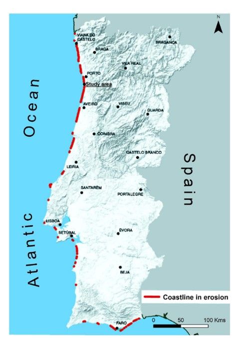

Sections of coastline under erosion (period 1958-2021); Source: Portuguese Environment Agency (APA) 2022Sections of coastline under erosion (period 1958-2021); Source: Portuguese Environment Agency (APA) 2022
Let´s go to the study area. Inside an Estuary and near a fishing villa and aquarium, it is supposed to be an elite beach, however, an emerging local to coastal erosion as said before in the north of Portugal and shown on the maps.

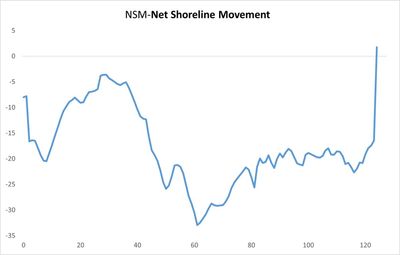

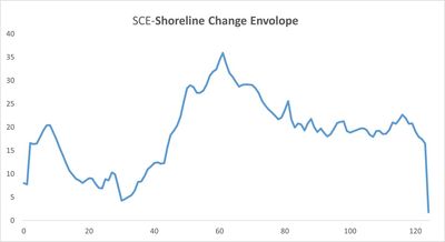

Besides the appearance of the sea going to the lands, how could we measure it? By the Digital Shoreline Analysis System (DSAS) with ArcGIS system to overlay (Oyedotun & Timothy, 2014) the software that tends to analyse the data science of polylines (in this thematic shoreline), including the average, maximum and minimum, shown in the graphs.
NSMNSMEPREPRSCESCE

The main results? In which, the coastline movement index shows (NSM) a negative advance towards land, with a maximum of 1,8 meters and a minimum of -33 meters, with an average of -17,90 meters. In average rate of change per year (EPR) is -1,13 meters, with a maximum of 0.18 meters and a minimum of -2,1 meters. On the coastline distance (SCE) the average was 18,72 meters, minimum of 4,3 meters and maximum of 36. The data presented beforehand reveals startling findings given the scale of sixteen years. Shocking data!

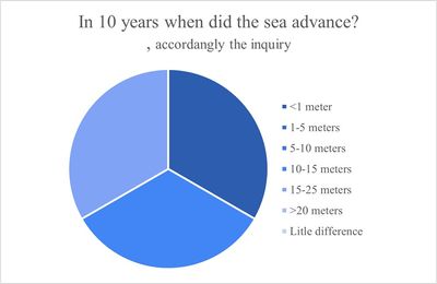

On the community side, we did a local survey with the following questions:
  • Knowledge of the term ‘Coastal Erosion’ (yes/no)
  • Knowledge of the impacts of ‘Coastal Erosion’ (yes/no)
  • Difference in beach size (yes/no)
  • Sea advance (metres)
  • Beach preservation and conservation strategies (yes/no)
The survey showed that the population inquired has been living in the parish for more than 20 years. There is also notable knowledge of the term “coastal erosion” and its impact on the beach. Concerning knowledge of the beach and its preservation, all the respondents said they were aware of the changes in the size of the beach and that, for the most part, there was no significant advance of up to 1 meter, which resulted in a negative hypothesis on their behalf. However, a substantial proportion of respondents reported an advance of between 1 and 10 meters, but in any case, never the correct measure (18 to 36 meters). In addition, half of the respondents were uninformed about beach conservation and preservation strategies.
Concept and Impact of Coastal ErosionConcept and Impact of Coastal ErosionAdvance of Coastal Erosion (Community Perception)Advance of Coastal Erosion (Community Perception)
