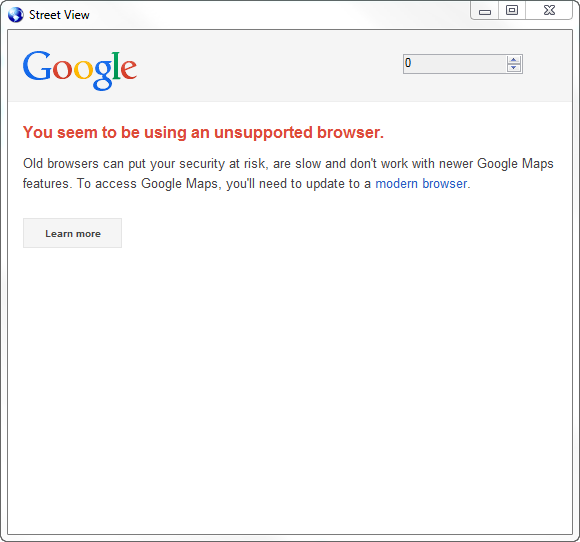

Using Visual Studio 2013 with C# to build and update the StreetView & Birds Eye View add-in. Issue is that starting last week the Web Browser Control, used on a form, starts displaying the following message.
Further research determined that the WebControl used in Visual Studio defaults to IE7 compatibility. To prevent the above warning you need to "set"  your preferred compatibility PRIOR to loading the form in HK_CU registry.
