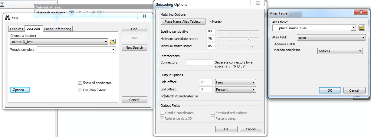

I am trying to use a place name alias table with my custom locator, but getting nowhere, so maybe someone can help.
I've tried to set the alias table with the creation of the locator and also, after the creation of the locator, in ArcMap, liked described in the ESRI documentation​, and none of these approaches worked.
My custom locator accepts one single input (a complete street address). My alias table as two columns: "name" (with the alias name of the building or place to localize) and "address" (with a complete street address that would be recognized by the custom locator).
The image bellow ilustrates the configuration of the alias table in ArcMap:
Any thoughts about what's going wrong?
Thanks

I was trying to use an Alias Table as described in the ESRI documentation about Alias Table. As I understand it, there is no explicit link between the Alias Table and the Primary Table. From the Alias Table the locator would get the complete address from the alias name, and the returned complete address would then be treated as input for geocoding.
Your table example seems to be an Alternate Name Table, with an explicit JoinID field, right? I thought the Altername Name Table would provide alternate name for the street name, not for a complete address name. In this way, having '#52 Some Name St' would return the same result as '#52 Altername St'. What I'm trying to accomplish is to give as input a common name 'CC Colombo' and the geocoding tool would process the correspondent full address in the alias table instead of the real input string. Is this correct?

I have a feature class that has points for each house number, therefore, provided a correct complete address, the locator is able to correctly georreference the address.
Are you saying that the place name alias table should have geometries associated? What kind of geometries? That's not what I understand from the ESRI documentation about it: The place-name alias table
My locator is able to georreference the address: "Avenida do Colégio Militar 37"
My place name alias table loks like:
So if I would type "CC Colombo", it should give me the location for the address "Avenida do Colégio Militar 37", right?

Here's what we lost in translation:  I always use the "ALTERNATE NAMES" table.  You are using the "ALIAS NAMES" table.
I just created a Single House  locator with the Alias Table Option.  However, in order to make it work, I had to go into properties, geocoding options and switch "Match without house number" and "Match without zone" to YES.
