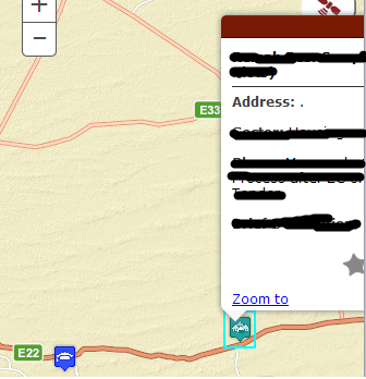

Hello,
I add to my map a popup
var popup = new Popup({
  fillSymbol: new SimpleFillSymbol(SimpleFillSymbol.STYLE_SOLID,
   new SimpleLineSymbol(SimpleLineSymbol.STYLE_SOLID,
   new Color([255, 0, 0]), 2), new Color([255, 255, 0, 0.25])),
  titleInBody: true
  }, domConstruct.create("div"));
  domClass.add(popup.domNode, "myTheme");
and set its content:
 var information = new PopupTemplate({
   "title": "{Field name}",
   "fieldInfos": [{
   "fieldName": "Field name",
   "format": {
   "places": 2,
   "digitSeparator": true
   "format": {
   "places": 2,
   "description": " html content"
and set this popupTemplate object to the featureLayer and set popup object to map
the problem is that the position of popup does not fit with screen look to image:
as you see if the feature is not on center of screen but on sides, the popup is displayed like this
this is a mobile application and mobile screen
please help as you fast as you can
and if there is another component can do this better please tell me
thanks.

Would manually setting an anchor help you at all? If you're using the Popup class, it's actually supposed to compute this automatically by default... Maybe setting it to the middle would decrease the effects of having the pop-up appear off screen.
https://developers.arcgis.com/javascript/jsapi/popup.html#anchor
Also, reposition may be helpful:
https://developers.arcgis.com/javascript/jsapi/popup.html#reposition
I've had similar issues in the past embedding maps within an iFrame - the pop-up would appear slightly out-of-frame... if the point feature is too far out, the anchor should reset upon re-opening (say from right/center to left), but this doesn't always happen, I've noticed. I've made a lot of changes recently, and it seems it does a better job now, so it may have been an issue with the container... I'm not sure.
I wonder if you could manually have the pop-up repositioned after a feature/map event, say a pan/zoom end. I'm trying this now...
ChrisSmith7
Honored Contributor
Seems to work - try this example in the sandbox:
ArcGIS API for JavaScript Sandbox
Adding something like this appears to help a bit when the pop-up is panned off-screen:
        map.on("pan-end", reposition);
        function reposition() {
          if (popup.isShowing === true){
            popup.reposition();
            console.log('pop-up repositioned...');
I added this bit of code right after line 125.
