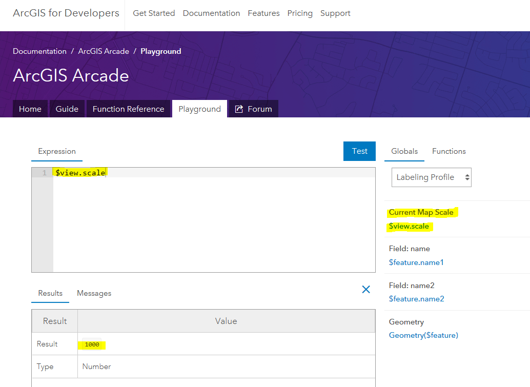

I'd like to be able to include the current map scale in the labels for a feature in Portal 10.5.1. The documentation on this page suggests that only the feature to be labelled is available as a global variable in Arcade expression
https://developers.arcgis.com/arcade/guide/profiles/#labelling
However within the playground section on the same site the current map scale is available under the labelling profile
Map scale available in Arcade expression on playground site

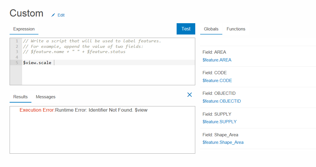

If I try to use the map scale global in an Arcade label expression on a layer in a Portal 10.5.1 web map I get an error about the view identifier not being found.
View scale not available in Portal 10.5.1 Arcade
I'm guessing that the reason it works in the playground is that the page is built with the JS API and that has a slightly different implementation of Arcade than Portal 10.5.1 perhaps? My question is will the map scale global be available in later versions of Portal?
However within the playground section on the same site the current map scale is available under the labelling profile. If I try to use the map scale global in an Arcade label expression on a layer in a Portal 10.5.1 web map I get an error about the view identifier not being found.
You are correct here - the only global variable currently available for the labeling profile is $feature and the global $view.scale will not work in Portal 10.5.1. There is a bug in the playground environment and we are actively working to correct that. Thanks for pointing it out!
As of now there are no concrete plans for adding $view.scale to the labeling profile. If you don't mind me asking, what is your use case for wanting to include current map scale in labels for a feature in 10.5.1?
Hope this helps!
