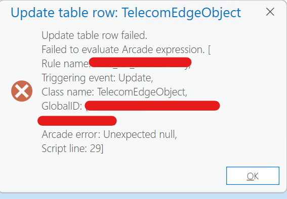

The rule triggers an error with unexpected null at line 21 where it tries to grab rings of the polygons. Not sure how to involve this conversion part.

This is resolved by excluding extra Geometry picking at line 20 above.
