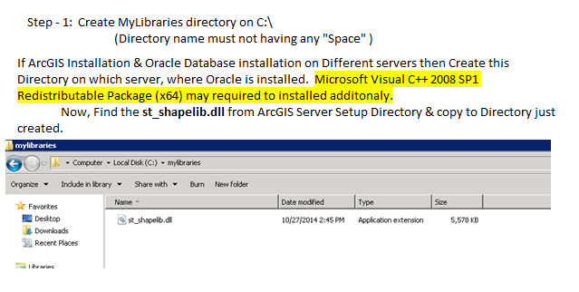

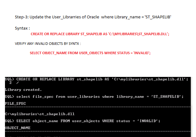

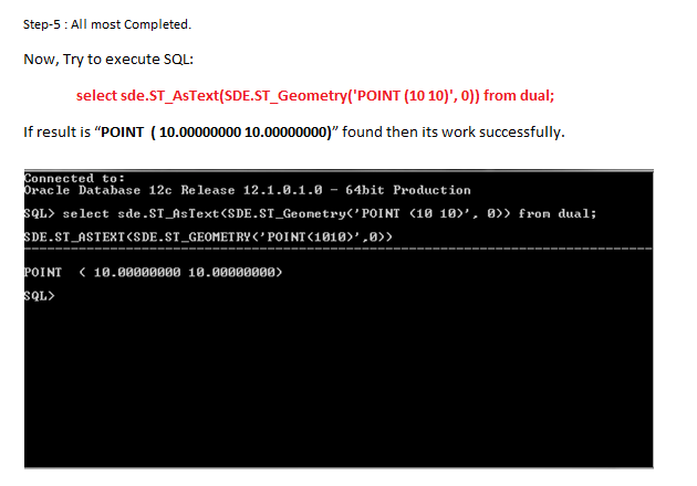

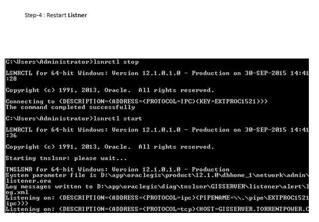

Steps to Configure ST_GEOMETRY by Configuring the Oracle extproc to access the geodatabase with SQL.
