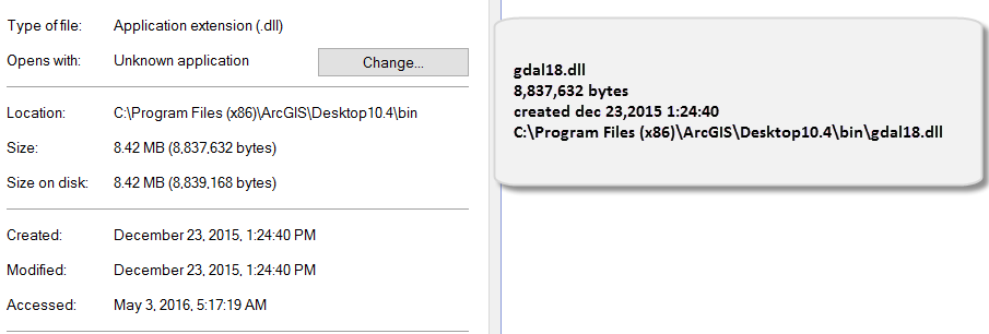

Here is the gdal info from the 10.4 install, how does it compare to the 10.3 version
MarkRubelmann
Deactivated User
Thanks Dan!  The one from 10.3 is 7.83 megs.  Different indeed!  I think Esri packaged up the wrong .lib in the sample.  Do you know if there's anywhere else to download the driver?
