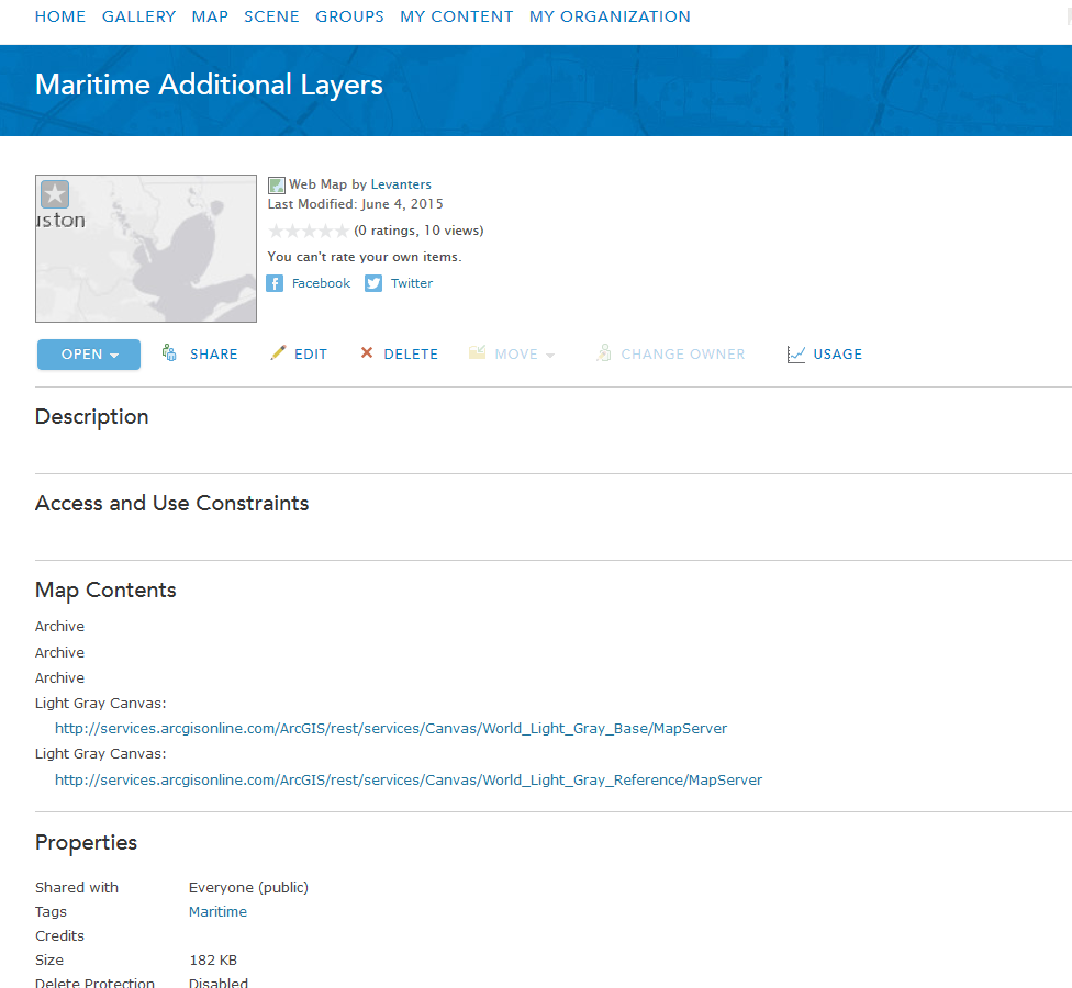

I don't see an export option:

Can you post a link to this map so I can help you further. Is this your map that you are hosting?

Matthew, I think I'm beginning to understand what you're trying to do. This appears to be an ESRI basemap that you have added to an ArcGIS Online map and then saved. In order to export a data layer, the data owner or administrator has  to configure the hosted feature layer to allow others to export the data. In this case, ESRI has not, so you can only use this basemap in Online or Desktop, and you cannot export it. What exactly are you aiming to do? There is probably a better way to get at it.

Ok, so you do have ArcGIS desktop then? If so, I would open this map in desktop, then use the tool Layer to KML (in Conversion toolbox) to export your layers. I don't think it's going to be possible from ArcGIS online, although I'm not certain.

Ok, thanks. So is it the  "archive" shapes that you are trying to export?
