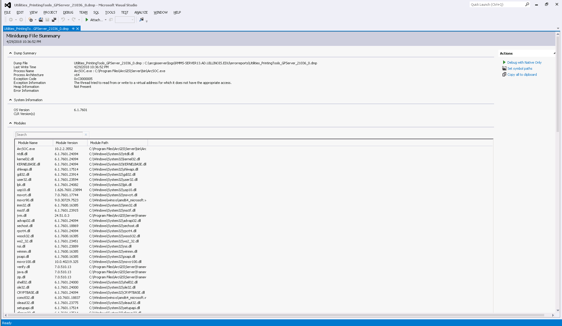

I further opened the error report and here is the summary,
Did anyone see the similar issue before? Please help!
TomWeisenberger
Having the same problem here.  It just started out of nowhere.  Dump file shows the same server OS Version, may be related to a Windows Update.
I opened a support case with Esri, will post any resolution.  Hao Hu did you get this resolved?
