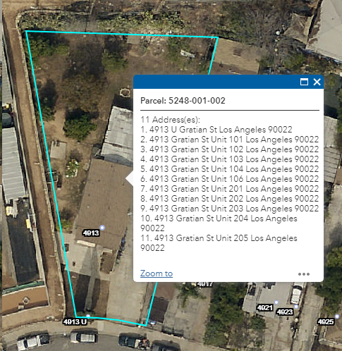

Hello:
I have an arcade expression that intersects and returns all addresses within a parcel if you click on the parcel. Is there a way to make this dynamic so it will zoom to an address when I click on one of the addresses in the popup?

I don't believe this is possible. Arcade has a few different profiles, but they're all pretty limited in scope to either the single feature, the layer, or the other layers in the map. The symbology profile can access the view scale, but that's about it. None of them can set properties in the map.
That said, it may be possible to use Arcade in something like a dashboard to generate a featureset which can be interacted with in the way you're looking for, but a dashboard may not be the solution you're looking for.
