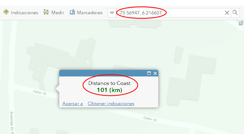

Hi [email protected] ,
When you add the layer to a web map in ArcGIS Online you can search for the lat lon location and click on the map to get the result:

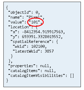

CharlieGrosvenor
Hello,
It returns:
{ "objectId": 0, "name": "Pixel", "value": "101", "location": { "x": -8412354.919917563, "y": 693391.3328019552, "spatialReference": { "wkid": 102100, "latestWkid": 3857 } }, "properties": null, "catalogItems": null, "catalogItemVisibilities": [] }
I assume that value is in kilometers. Is there a way to make it return something different?
Thanks
XanderBakker
Esri Esteemed Contributor
I'm sorry, but yes the pixel type of the service is U16 (unsigned 16 bit integer, range 0 to 65535), so you will not obtain a decimal value.
