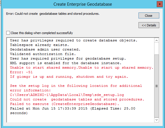

we are using ArcGIS 10.3 and have SDE master geodatabase and one user geodatabase already.
However, when i am trying to create a second user geodatabase, I get the below error.
"Unable to start shared memory. If giomgr is up and running, shutdown and try again"
We have tried checking the database parameters for memory issues but could not find a cause.
Can someone please help on this. Thanks.

The same information is written to the sde_setup.log. there are no extra errors. Below are the details.
[Wed Jun 17 14:39:14 2015] LOGFILE_POOL tables created...
[Wed Jun 17 14:39:14 2015] DBTUNE table being created...
[Wed Jun 17 14:39:14 2015] DBTUNE table created...
[Wed Jun 17 14:39:14 2015] SERVER_CONFIG tables being created...
[Wed Jun 17 14:39:14 2015] SERVER_CONFIG tables created...
[Wed Jun 17 14:39:14 2015] SDENUMTAB type being created...
[Wed Jun 17 14:39:14 2015] SDENUMTAB type created...
[Wed Jun 17 14:39:15 2015] DBMS stored procedures being created or updated...
[Wed Jun 17 14:39:18 2015] DBMS stored procedures created or updated...
[Wed Jun 17 14:39:18 2015] Unable to start up shared memory. Error: -51
If giomgr is up and running, shutdown and try again.
[Wed Jun 17 14:39:18 2015] SDE schema object install not completed.
[Wed Jun 17 14:39:18 2015] ERROR installing/upgrading ArcSDE, Error = -530

All the other privileges are already there except DBA.
Grant DBA to <user_schema> worked.
