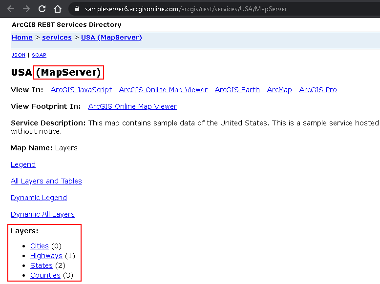

That is not correct. You can work with map services, but to have full functionality you will need to add each layer separately. Take a look at the sample service of the USA:
USA (MapServer)
It is a Map Service with 4 layer:
If you add the service to AGOL using the URL "https://sampleserver6.arcgisonline.com/arcgis/rest/services/USA/MapServer " it will be added as a group layer and functionality will be limited to only the attributes of the current feature.

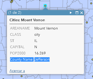

When you add then individually adding "/0" for the Cities and "/3" for the Counties, you can use Arcade normally to extract the county name for the city like this:
return First(Intersects($feature, FeatureSetByName($map,"USA - Counties"))).name;
Which will appear in the pop-up:
