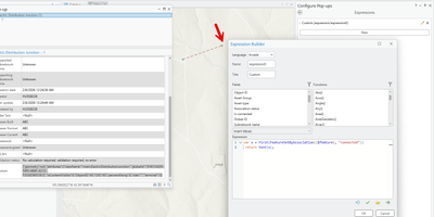

FeatureSetByAssociation returns a featureset, so you would need to either loop or do a First to get the association row.
Best quick test is to use a Popup and click on one of the junctions that have connectivity associations.
var x = First(FeatureSetByAssociation(($feature), "connected"))
if (x == null)
    return "No connected feature"
else
    return text(x);
You should get something like this
{"geometry":null,
"attributes":
{"className":"main.ElectricDistributionJunction",
"globalId":"{F4013AD9-F4F0-4B6F-A212-F353ED90F2B1}",
"isContentVisible":0,
"ObjectID":65,
"OID":65,
"percentAlong":0,
"side":"",
"terminal":1}}
