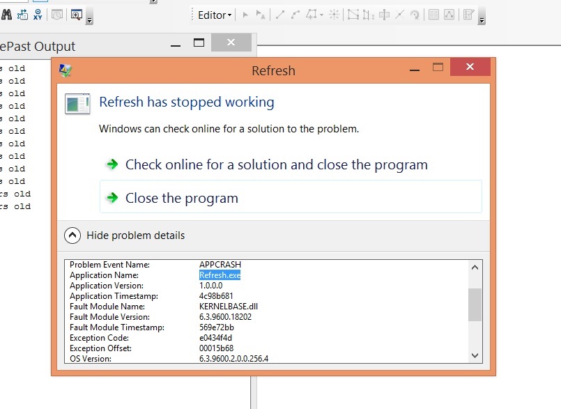

Hello All, I use ArcGIS 10.4. and Win 8.1. .I have a problem with Agent Analyst in a model-level action. I did all steps of the Exercise 2f in the book.The model start running, the Repast output suddenly stopped working, and an error shows " refresh has stopped working".
error
As a result, the updateDisplay action in Agent Analyst does not update my ArcMap display. would you please help me to solve the problem?
Thanks and regards,
SaharSha
Deactivated User
I created a virtual C: Drive with Windows 7 on my Windows 8 and installed ArcGIS 10.2 on virtual Drive. then I went through the structures mentioned in this page:
Agent Analyst tool interface will not open on ArcGIS for Desktop? - Geographic Information Systems S...
The problem fixed.
