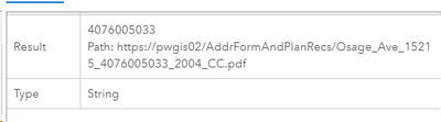

I was able to get it to work utilizing the code @XanderBakker provided at this link: https://community.esri.com/t5/developers-questions/get-1-m-related-objects-using-arcade/td-p/736778
The related field I want to display multiple related records for in the popup are hyperlinks. They show as text using the solution I used so I tweaked it to only show one hyperlink rather than all. How can I adjust it so are related hyperlinks are shown?

I appreciate your help and for the script. I assume if(Count(relatedFeatures)) was supposed to be if(Count(relatedData)) correct? I am getting the same error message which was
I think it still has to do with the issue at this link because the error message I am getting is the same.
