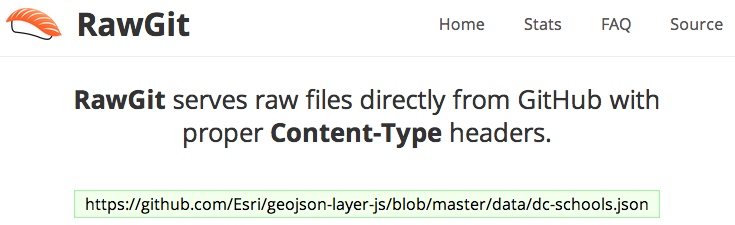

2. Go to RawGit and paste in the url

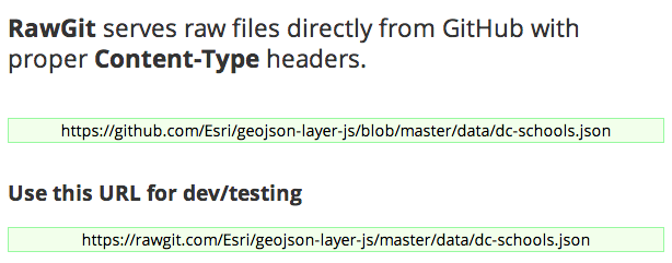

3. Use the dev or prod RawGit reference in your apps
Here's an example where I used RawGit to change a bunch of the local .js and .geojson references so I could run the app from fiddler.
