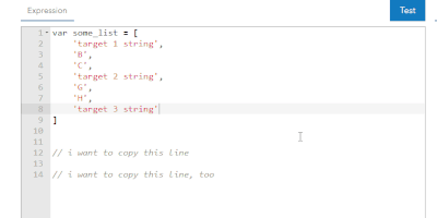

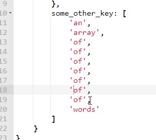

Multiple Cursors
This was the biggest one for me. Just hold the Alt key, then click and drag. For a keyboard-only method, hold Ctrl + Alt and press Up or Down to add a cursor above or below the "primary" line (the one highlighted in yellow). Note that if you already have an active cursor in that direction, this will just change which line is "primary".
Click and drag with the mouseClick and drag with the mouse
Adding cursors and moving the "primary" line with keyboard commands.Adding cursors and moving the "primary" line with keyboard commands.
And if you need to select lines that aren't adjacent, just Ctrl + Alt and click.
Adding Multiple Cursors to Specific Text
You know how if you highlight text in your editor, you can see other instances of the text faintly highlighted? Have you ever wanted to certain occurrences of, say, a variable name?
Ctrl + Alt + Right or Left will add a cursor to the next / previous occurrence of the selected text.

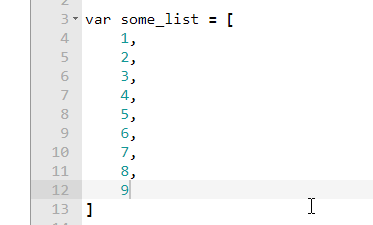

Increment or Decrement a Number
Ctrl + Shift and the Up or Down Arrow will increment your integers. Correctly interprets negative numbers, too!
Note that this will "target" the number to the left of the cursor, so you can adjust specific decimal places or the tens, hundreds, etc.

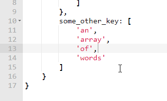

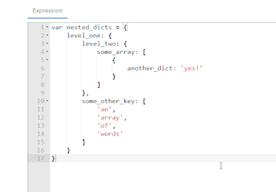

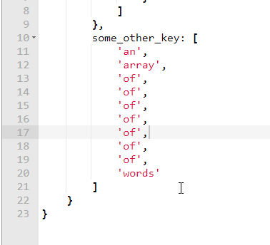

Duplicating Text
Duplicate Selection
Ctrl + Shift + D will duplicate your current selection.
Duplicate Current Line
Alt + Shift + Up or Down will duplicate the current line. This one has always felt a bit counter-intuitive to me, but I think of it as the arrow key is what direction you want to move the cursor, leaving behind a copy. So Up will move the cursor up, and leaves behind the copy below. To my eyes, it just looks like I'm pressing Up to create a copy Down, but oh well.

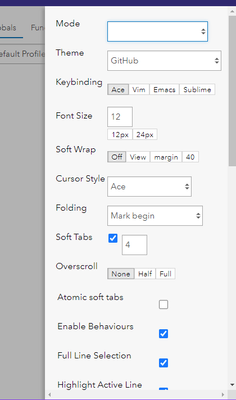

In Closing: Change Your Settings!
There are more shortcuts than these, and I encourage you to play around and see what else you can incorporate into your work to make things more efficient.
The last thing I want to mention is my favorite. Ctrl + , will open the settings menu. You might not have known that this even existed, but it does!
There's a lot in here worthy of its own post, but you can probably just look at the Ace docs for that. Odds are, though, there's a setting or two in here that you might like to change, especially the theme. Prefer Solarized Dark or Monokai? You can have it!
