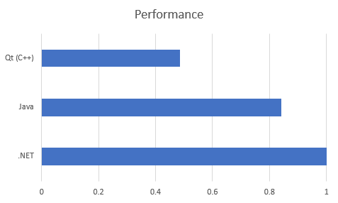

As a fun exercise, I decided to compare the three flavors of Runtime 100.12 available for Windows desktop (.NET, Java, Qt).  Again, I used the same purely computational benchmark: creating convex hulls for 100,000 random polygons.  I built all three examples as standalone console applications (release builds), and executed them outside of their respective IDEs.  I ran each benchmark five times, and picked the best time for each.
Here's the benchmark comparison:
Runtime SDKExecution time (seconds)
.NET16
Java19
Qt (C++)33
And here's the normalized performance index:
I expected .NET and Java to be pretty much neck-and-neck, since no COM interop is involved in the benchmark (COM interop perfomance is much worse in Java than .NET).  Qt was a bit of a surprise; although, I've dabbled with Runtime for Qt in the past, and noticed that fine-grained code seems not to be as fast as it could be.  While C++ is my favorite programming language, and I admire Qt's "write once, deploy many" approach, it's obvious that the framework carries some baggage.
