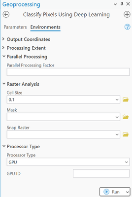

  • Share screenshot of Classify Pixels Using Deep Learning tool parameters.

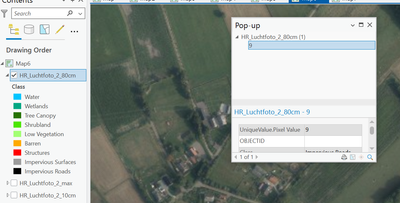

1. With the output raster which you are not able to see and seems blank:
  • In the below screenshot we can't see "HR_Luchtfoto_2_80cm" raster in the map and seems blank raster:
  • But when I use explore and click on the map I can see the rasters class values:

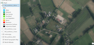

  • By adding the raster in a new map we can see the raster in the map:
  • You can try this for your output raster.
2. Changing cell size in Classify Pixels Using Deep Learning tool:
3. By visual interpretation the raster which you shared doesn't seem like it's spatial resolution (cell size) is 10 cm so you can also try High Resolution Land Cover Classification - USA (https://www.arcgis.com/home/item.html?id=a10f46a8071a4318bcc085dae26d7ee4) which works for raster with cell size between 80cm - 1m.
