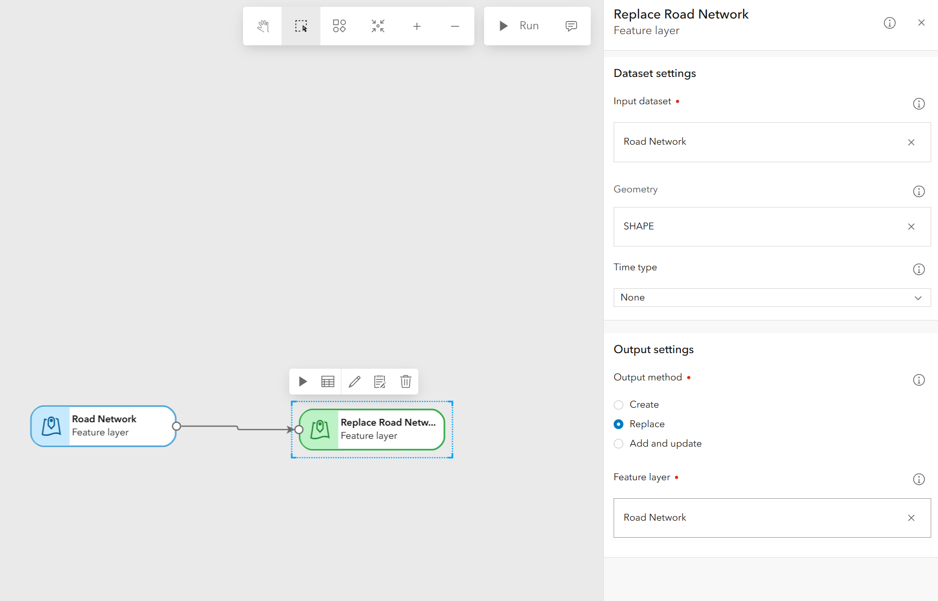

I have an AGOL feature layer (published from ArcGIS Pro) and for some reason I can' get the Pipeline the Replace to work
it's a very basic flow: Pushing data from Portal to AGOL
I keep getting this message: The selected layer does not support the truncate operation

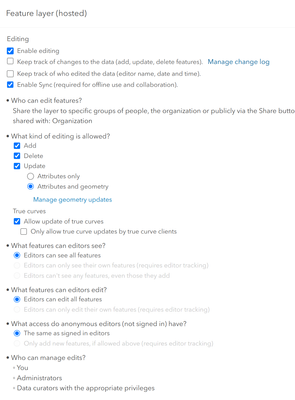

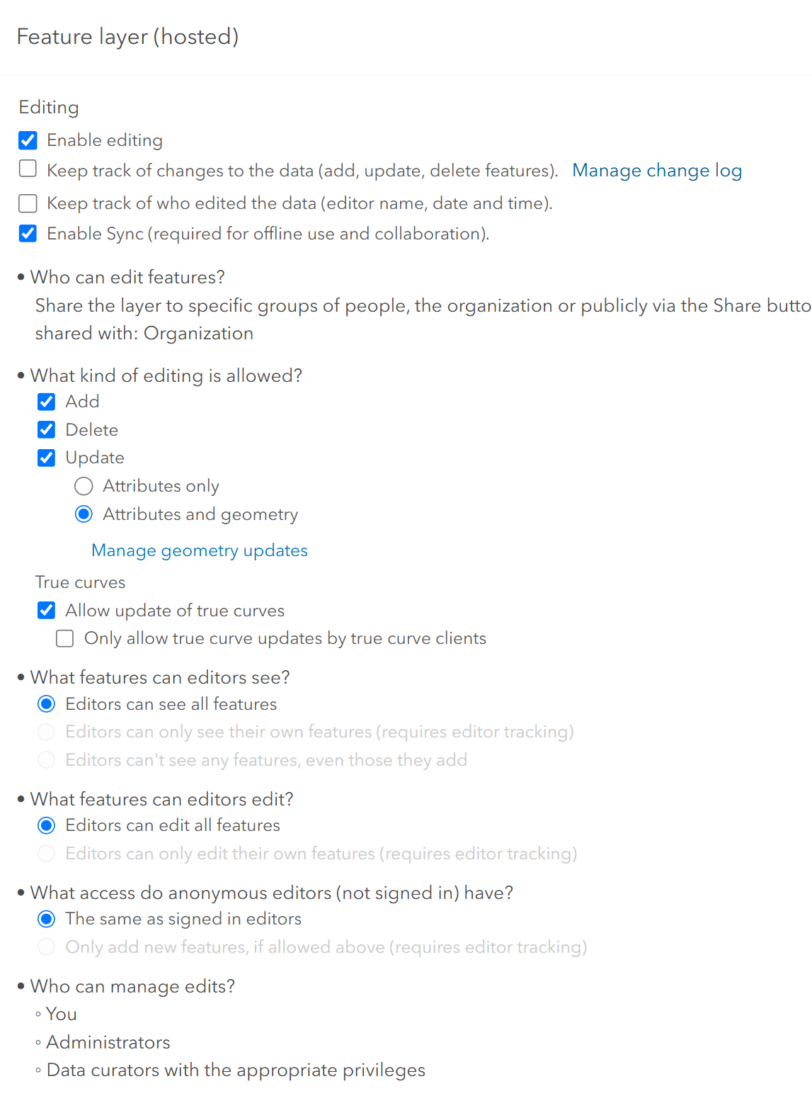

Feature service settings:
Could it be that's because I have a VIEW related to that feature service?
I have another flow very similar (target is an AGOL native feature service) no VIEWs and the Pipeline works just fine
Both targets have "supportsTruncate" : false, so I don't think it's the issue.

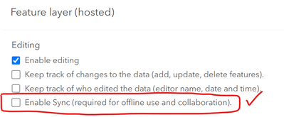

I unchecked the "Enable Sync" and everything started to work just fine.
