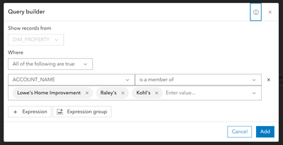

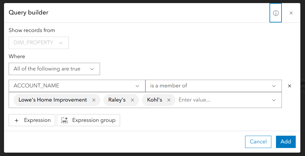

I have a string field that I would like to filter my source table by. Some of the records have an apostrophe in the name (for example, Lowe's Home Improvement)

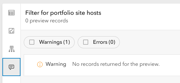

I am able to find these records in the dropdown options in the SQL builder interface. However, when I preview or run the Data Pipeline, it doesn't return any records.

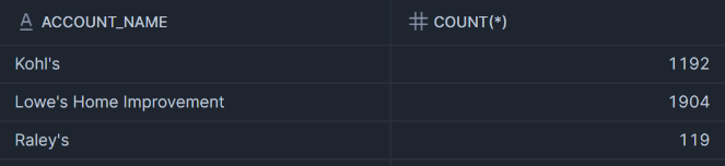

These records do in fact live in the source dataset. Below is a screenshot of the # of records I would expect it to return (from our Snowflake environment).

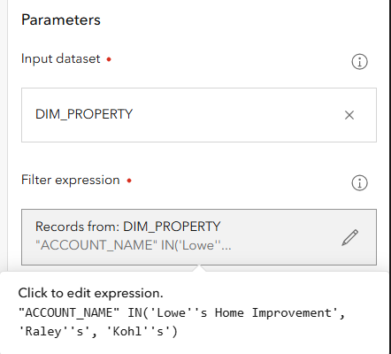

Edited to Add:
It looks like (at least on the front end tooltip...) that the SQL query is properly using the double apostrophe for these records. Perhaps this logic is missing from the actual query on the backend?

But I was able to use the text "contains" option which uses the LIKE function. If I enter 'Lowe%s Home Improvement', it returns the missing values.
