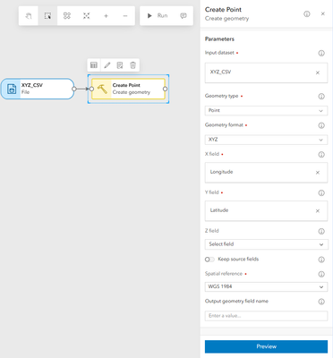

Data Pipelines currently does not support geocoding (enabling location from addresses). However, in the meantime you can use the tool Create geometry to enable geometry using coordinates.
Here is the doc for the Create geometry tool: https://doc.arcgis.com/en/data-pipelines/latest/process/create-geometry.htm
And here is an example of how the tool looks when populated using Long/Lat coordinates from field values:
Please let me know if you have any questions.

Thanks. We ended up using the capability to create and update a feature layer from a Google Sheet for this particular application.
https://support.esri.com/en-us/knowledge-base/how-to-add-and-update-google-sheets-data-in-arcgis-onl...
