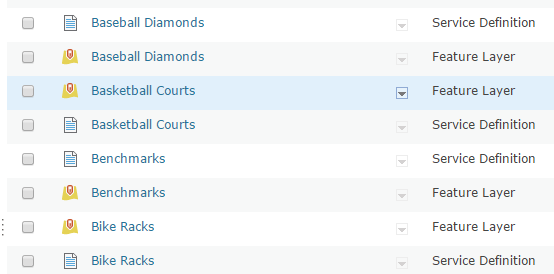

I have a python script that was adapted from update-hosted-feature-service/update.py at master · arcpy/update-hosted-feature-service · GitHub  that uses an oracle table instead of the ini file to loop through AGOL updates. The table has the AGOL name, the mxd name, tags etc.that is updates but. It works fine when there are no spaces on the AGOL side but fails in the def publish(self) section on line 230  when there are spaces in AGOL.   So for example if I have Bike Racks as BikeRacks on AGOL, it will run. I am pretty sure it is a simple error but I can seem to see it.
Line 230: return jsonResponse['services'][0]['serviceItemId']
Error
KeyError: 'services'

Thank you to  Jing Yan from Esri Canada for figuring this one out.
Here is the solution:
In  ArcGIS Online, the title of an item is stored in an “title” parameter (e.g. “Nicer Name”), while the original service name/SD file name is stored in a “name” parameter (e.g. “SqueezedName.sd”).
The high-level steps are:
1)    Use service name, e.g. “Nicer Name”, to fetch the same titled item, and then get item ID to decide which item and its SD to update.
2)    Fetch the original service name/SD file name, e.g. “SqueezedName”, through the item name parameter, and use “SqueezedName” to create new SD and overwrite the original service.
3)    Now the item title “Nicer Name” will be reverted back to its original service name “SqueezedName”. So the last step is to use Update Item operation to update item title with “Nicer Name”, i.e. the service name defined in settings.ini, or from the spreadsheet in your case.
