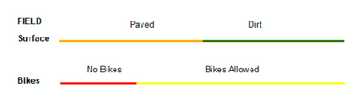

I'm working on a trails database that has many (too many!) fields and am looking for a way to break some of them out, but still be able to symbolize on them. The general issue is this:
Our trails dataset has Surface, Bikes, ADA, Horses, Type, etc fields. Each attribute defines use along different segments of the same trail.
For example, for a  trail from point A to point B, I need to split the line based on a Surface field when the trail changes from paved to dirt. But for a different map I may need to symbolize where bikes are and aren't allowed, splitting the line at a different location. The line is the same, but the splits are different for each field.
With literally 20+ fields in the file I don't want to have a million split lines. Any ideas on how to pull some fields out, but join, relate, create topology rules to bring them back in to symbolize, etc?

Sounds like a great case for linear referencing if you want to put (and maintain!) measure values on your trails  https://pro.arcgis.com/en/pro-app/latest/help/data/linear-referencing/introduction-to-linear-referen...

PERFECT! Thank you!
