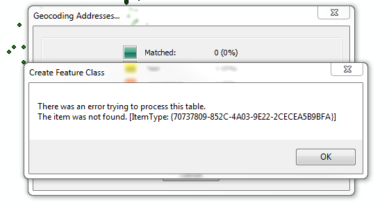

I have a dataset of about 32000 addresses I have been trying to geocode. Time after time I keep getting the same error message, the one in the title of this thread. I have changed names of columns, tried making it a dbf, tried removing everything but the address information, splitting the data in half to make it smaller. Regardless of what I do i get anywhere from 1%-5% done and I get the error.
Any ideas?
Thanks.

My solution was to geocode into a gdb and not a shp.  I used an xlsx sheet and a csv.

It's possible that there was a field type in your table that was not supported by shapefile format, which could explain why using a file gdb for geocode output worked.

Just wanted to add to this conversation. I was receiving this error when trying to geocode a csv to a feature class:
And I went through a variety of steps to try to resolve:
- checked field names
- checked for weird characters in the addresses
But then I tried exporting as a shapefile instead of a feature class and it worked great. Hope this helps!
